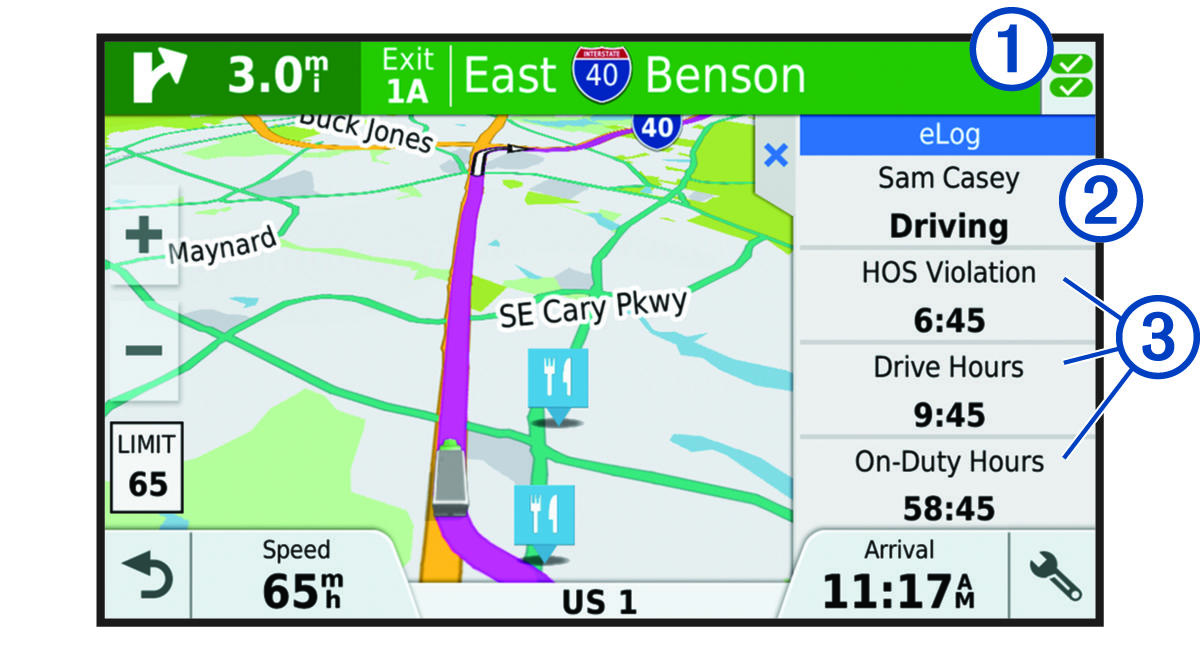

The Garmin eLog™ map tool appears on the navigation map automatically while your device is connected to a Garmin eLog adapter. If you close the map tool, you can open it manually by selecting Options wrench > Garmin eLog from the map.
As you drive, the device displays your duty status and hours of service information in the Garmin eLog map tool.
Map with eLog tool and callouts
Callout number one
Diagnostic and malfunction indicator. Select to view detailed information about diagnostic or malfunction alerts (Viewing Diagnostics and Malfunctions).
Callout number two
Driver name and duty status. Select to change the driver's duty status (Changing Duty Status).
NOTE: You cannot change your duty status while driving.
Callout number three
Current remaining drive hours. Select to view detailed drive hours information in the Garmin eLog app.
