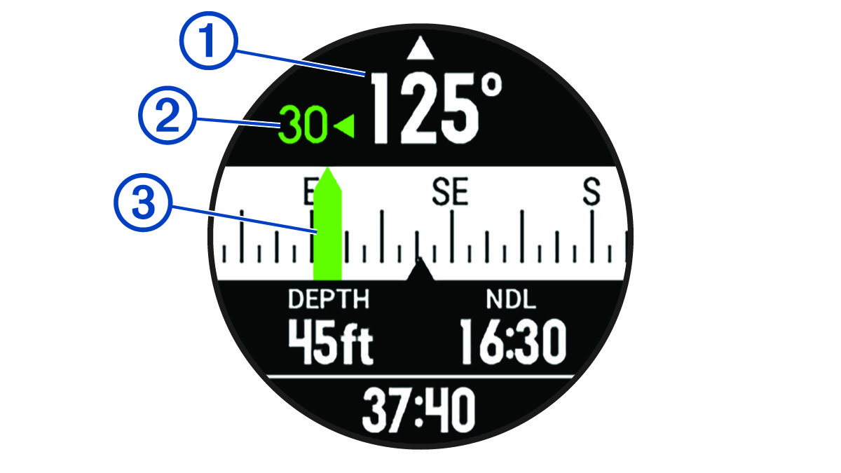

During a single-gas, multi-gas, closed-circuit rebreather, or gauge dive, scroll to the dive compass.
The compass indicates your directional heading
Press
to set the heading.
The compass indicates deviations
from the set heading
Press
, and select an option:
To reset the heading, select Reset Heading.
To change the heading by 180 degrees, select Set to Recip..
NOTE: The compass indicates the reciprocal heading with a red mark. -
To set to a 90-degree heading left or right, select Set to 90L or Set to 90R.
To clear the heading, select Clear Heading.
