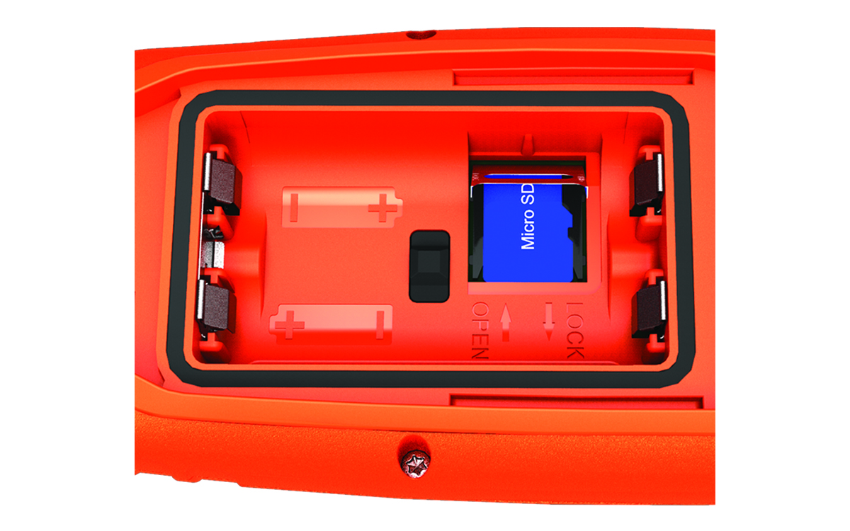

You can install a microSD® memory card in the handheld device for additional storage or pre-loaded maps.
  1. Turn the D-ring counter-clockwise, and pull up to remove the cover.
  2. Remove the battery.
  3. Slide the card holder to the left and lift up.
    Close-up view of inserting the memory card into the device
  4. Place the memory card with the gold contacts facing down.
  5. Close the card holder.
  6. Slide the card holder to the right to lock it.
  7. Replace the battery and cover.
