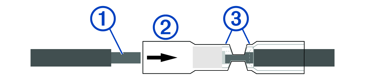

  1. Using wire strippers, strip 6 mm (1/4 in.) off the end of each bare wire.
  2. If necessary, twist the strands of each wire Anotación número uno clockwise to bundle them together.
    Montaje del conector de engarce termocontraíble con anotaciones
  3. Insert one bare wire into one end of the heat-shrink crimp connector Anotación número dos.
    The bare wires are not secure until they are crimped and sealed.
  4. Insert the corresponding bare wire into the other end of the heat-shrink crimp connector.
  5. Using pliers, crimp both sides of the center of the connector Anotación número tres to secure the connection.
  6. Using a heat gun, apply heat to the heat-shrink crimp connector until the connector is sealed to the wires.
    Do not apply heat to the wires directly.
