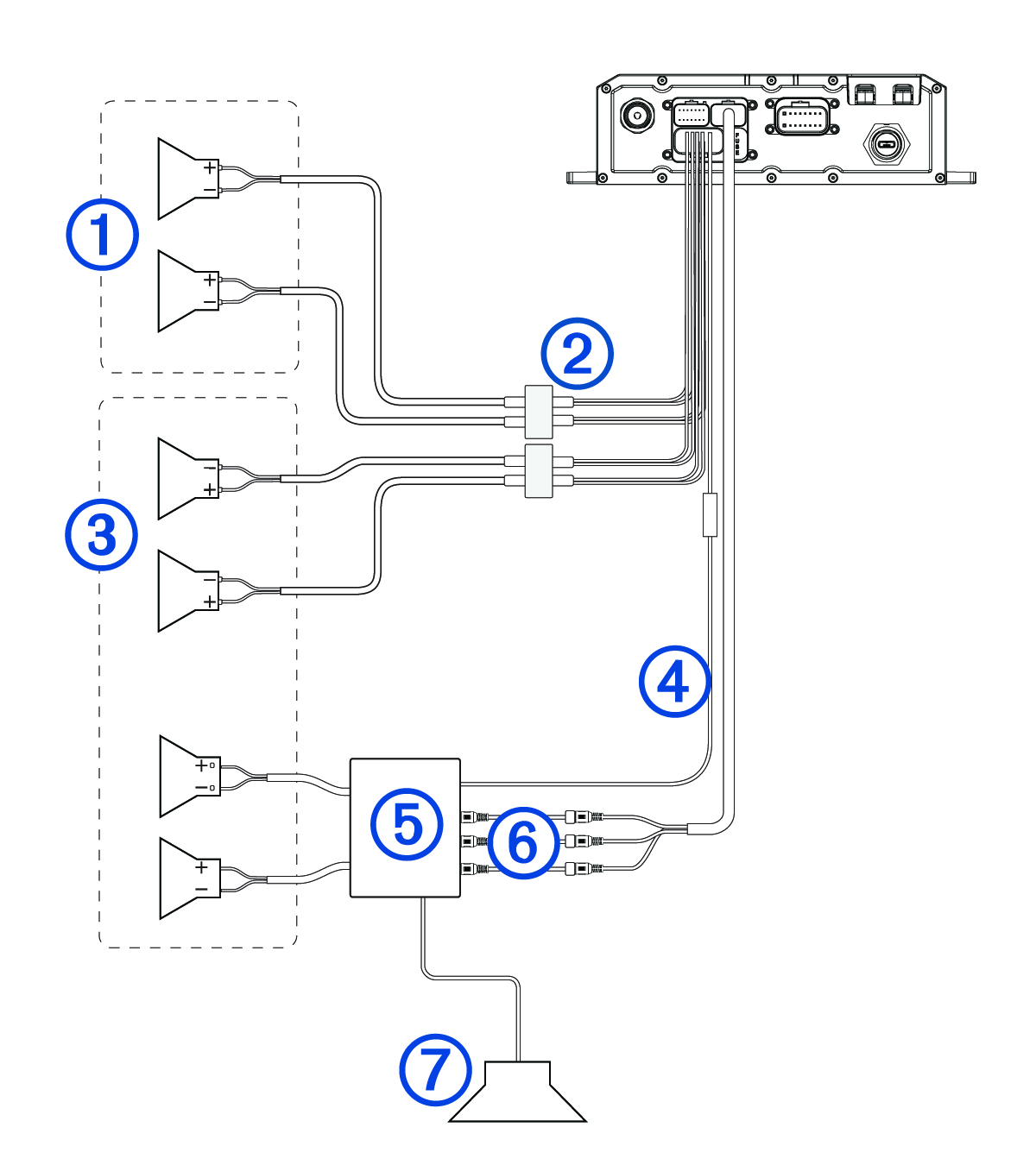

Complete System Wiring
This diagram illustrates a system installation with an external amplifier and subwoofer connected to the stereo using a line out.
NOTA: You can also connect speakers to the speaker wires for the internal stereo amplifier while using an external amplifier connected to the line out. Adjusting the volume affects speakers connected to the internal amplifier and speakers connected to the line out. This may result in uneven volume levels.
Diagrama de cableado del dispositivo con anotaciones
Item
Description
Anotación número uno
Zone 2 speakers
Anotación número dos
Water-tight connection
Anotación número tres
Zone 1 speakers
Anotación número cuatro
Amplifier-on signal wire
Anotación número cinco
Powered amplifier
Anotación número seis
Line out and subwoofer out
Anotación número siete
Subwoofer
