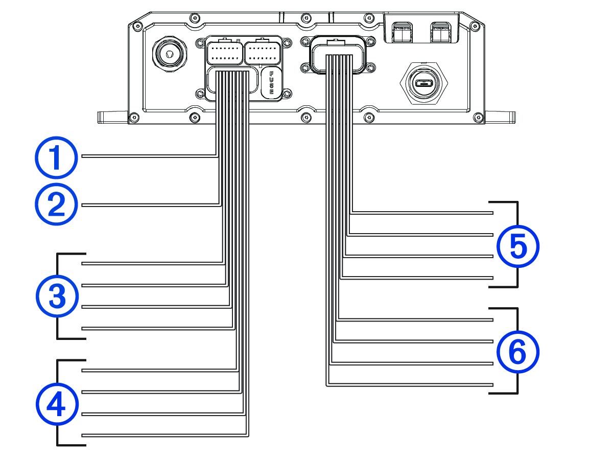

Arnés de cableado del altavoz del dispositivo con anotaciones
Wire Group
Wire Color and Description
Anotación número uno Ignition
Red: Connects to the vehicle accessory line. If the ignition wire is unused, ground the ignition wire or leave it disconnected.
Anotación número dos Amplifier on
Blue: Connects to an optional external amplifier to turn it on when the stereo turns on.
Anotación número tres Speaker zone 1
White: Left (+), Connects to the included speaker.
White with a black stripe: Left (-), Connects to the included speaker.
Gray: Right (+), Connects to the included speaker.
Gray with a black stripe: Right (-), Connects to the included speaker.
Anotación número cuatro Speaker zone 2
Green: Left (+), Connects to an additional speaker.
Green with a black stripe: Left (-), Connects to an additional speaker.
Purple: Right (+), Connects to an additional speaker.
Purple with a black stripe: Right (-), Connects to an additional speaker.
Anotación número cinco LED RGB1
Black: Power
Red: Red LED
Green: Green LED
Blue: Blue LED
Anotación número seis LED RGB2
Black: Power
Red: Red LED
Green: Green LED
Blue: Blue LED
