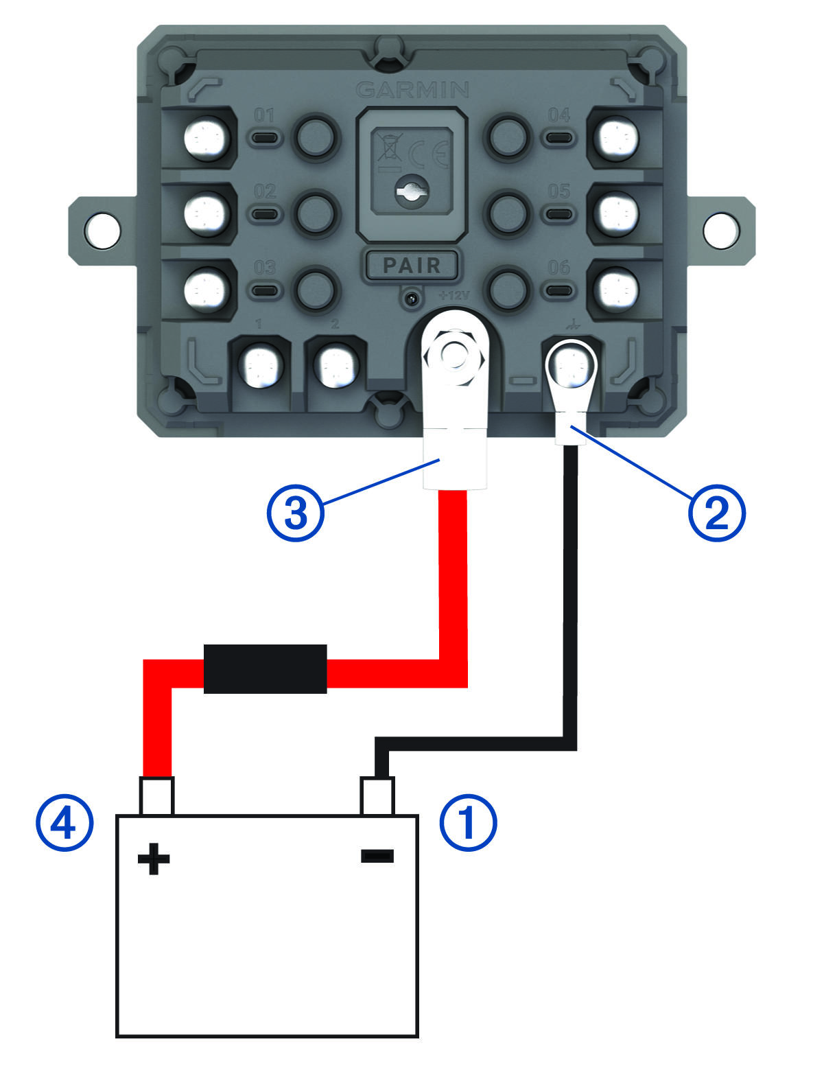

  1. Connect the large ring end of the included ground wire Callout number 1 to the negative terminal on the vehicle battery.
    Wiring diagram of power and ground connections with callouts
  2. Connect the small ring end of the ground wire to the GND terminal Callout number 2 on the device.
  3. Connect the small ring end of the included 12V cable to the +12V terminal Callout number 3 on the device.
  4. Tighten the 3/8 in. nut on the +12V terminal to a maximum torque specification of 4.52 N-m (40 lbf-in.).
    You should confirm the nut cannot be loosened by hand.
    NOTICE
    Do not overtighten the +12V terminal to prevent damage to the terminal.
  5. Connect the large ring end of the 12V cable Callout number 4 to the positive terminal on the vehicle battery.
