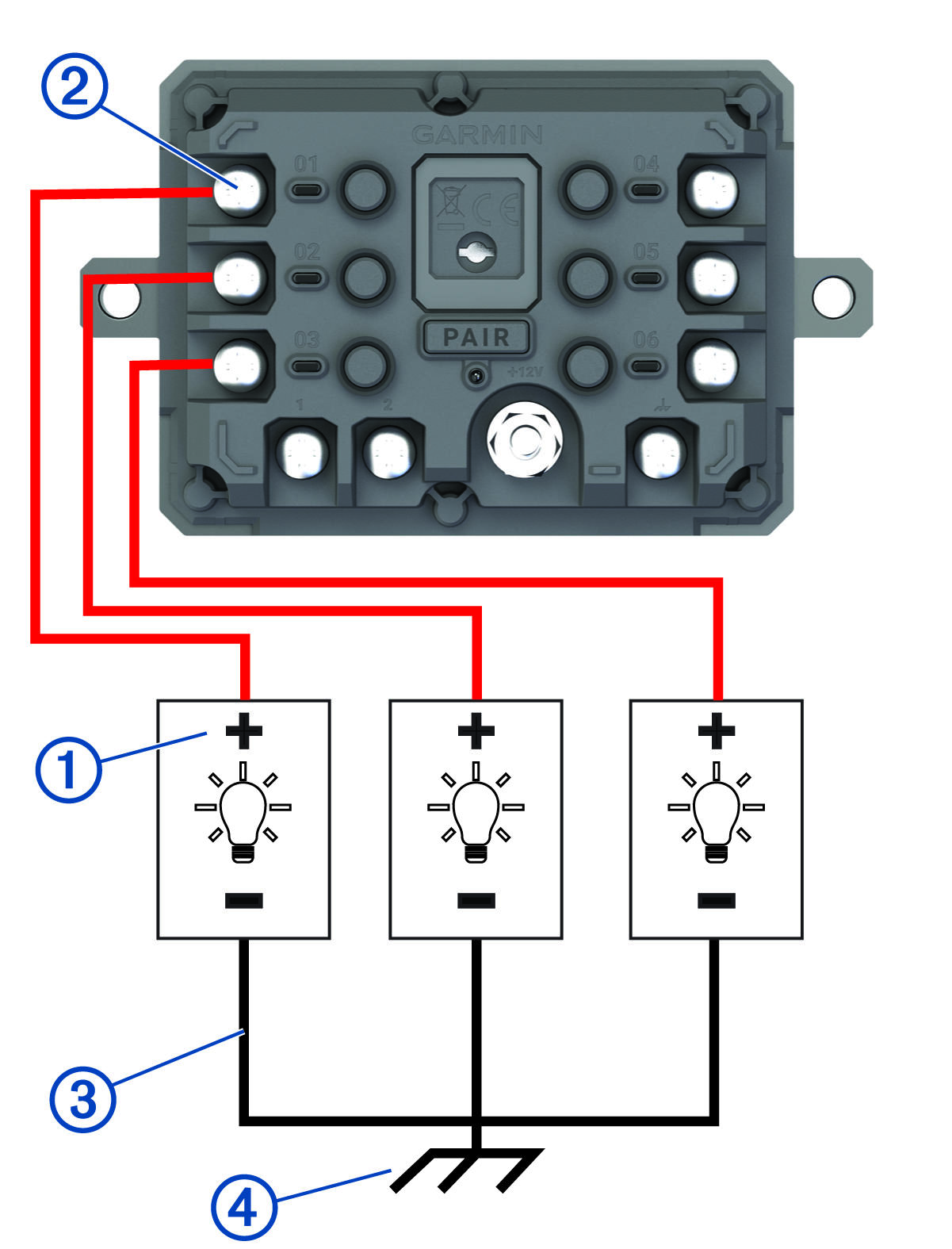

  1. Connect the positive wire from the accessory Callout number 1 to one of the accessory terminals Callout number 2 on the Garmin PowerSwitch device.
    Wiring diagram of power and ground connections with callouts
  2. Connect the negative or ground wire Callout number 3 to an unpainted ground stud Callout number 4 on the vehicle frame, to a ground distribution block, or directly to the negative terminal on the battery.
    CAUTION
    Do not connect the accessory ground wires to the ground terminal (GND) on the Garmin PowerSwitch device, as doing so could result in personal injury or property damage, or could negatively impact device functionality.
  3. Verify that all electrical connections are tight and will not come loose during use.
