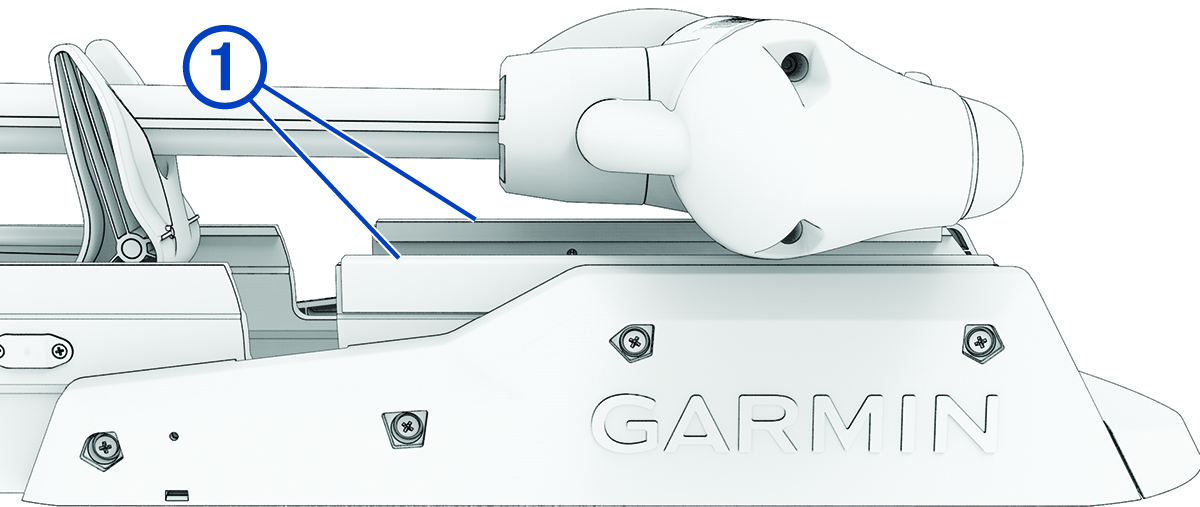

  2. If necessary, adjust the depth of the motor so that it will rest on the rails 1 on the mount base (Adjusting the Depth of the Trolling Motor).
    NOTICE
    You must make sure the motor rests solidly on the rails when in the stowed position. If the motor depth is too shallow, it may press on the gas spring. If the motor depth is too deep, it may hang off the end of the mount base. Stowing the motor without resting it on the rails damages the motor.
    Proper motor stowed position with callout

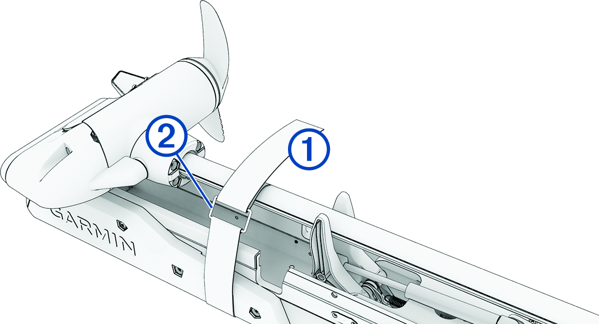

Securing the Safety Strap
CAUTION
You must always secure the safety strap after stowing the trolling motor to prevent the motor from deploying unexpectedly. An unexpected deployment of the motor may lead to personal injury and damage to your boat and to the trolling motor.
The safety strap holds the motor securely to the base in the stowed position and prevents unintended deployment.
  1. With the motor in the stowed position, lift the long end of the strap 1 over the top of the motor.
  2. Feed the end of the strap through the buckle 2 on the other end of the strap.
  3. Pull the strap through the buckle until it holds the motor securely to the mount.
  4. Pull the strap away from the buckle, and push down to fasten it to the other side of the strap.
