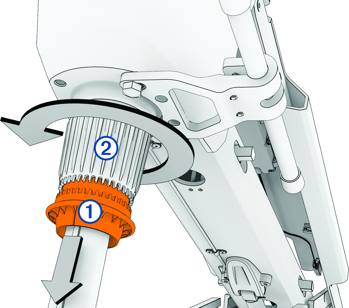

  1. Move the motor so that it stops halfway between the stowed and deployed positions.
  2. Slide the locking ring 1 down to unlock the depth adjustment collar.
  3. Loosen the collar 2 to unlock the shaft.
    NOTE: You should be prepared for the motor to slide down when you loosen the collar.
  4. Raise or lower the depth of the trolling motor.
  5. Tighten the collar at the base of the steering system housing.
  6. Slide the locking ring on the depth adjustment collar back up.
