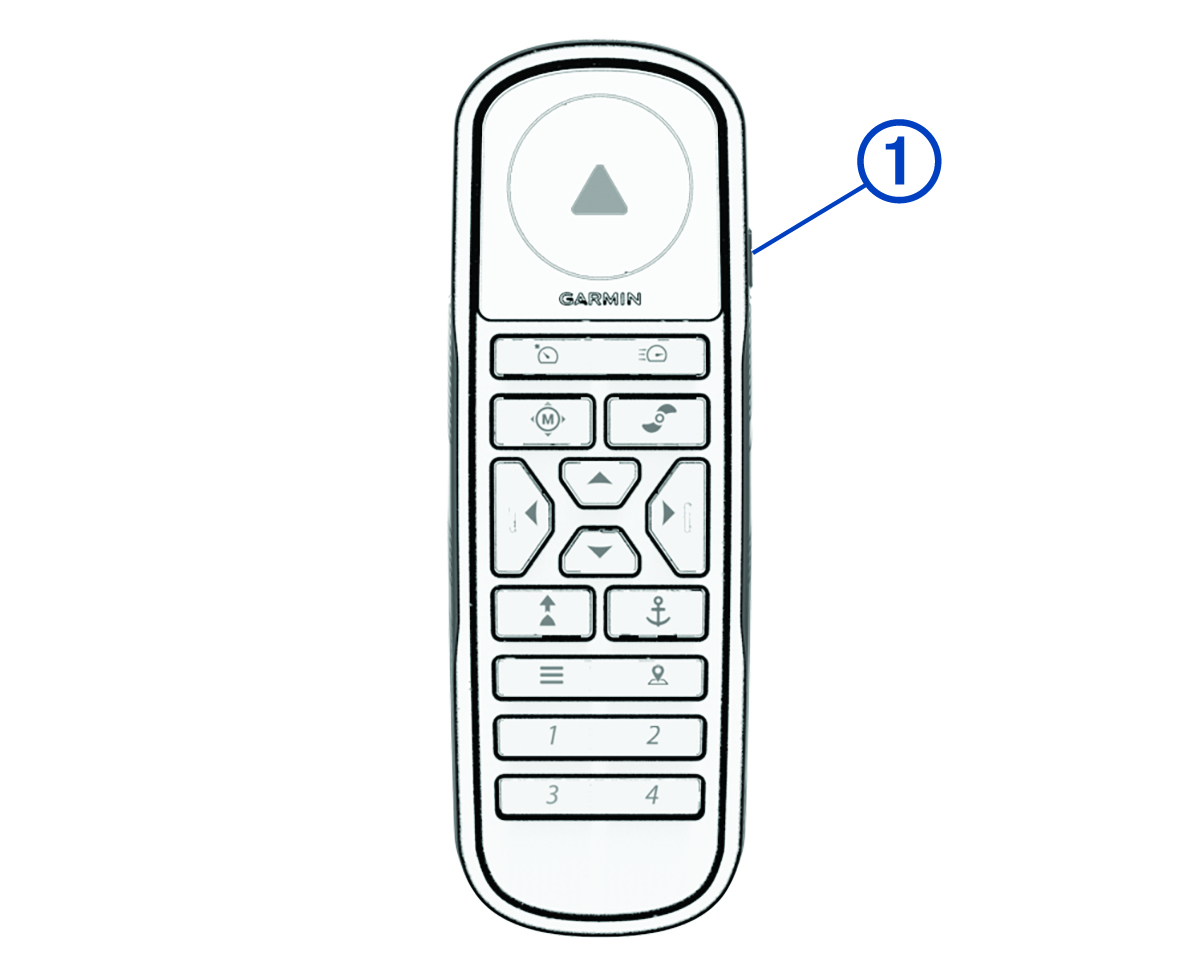

Remote Control
Remote control with callout
Button
Description
1 Power icon
Hold to turn the remote control on and off.
Speedometer icon
Press to turn on and set Cruise Control at the current speed over ground (SOG) (Maintaining Your Speed).
Press again to disable Cruise Control and return to manual speed control.
Maximum speed icon
Press twice to turn on the propeller and set it to full speed.
Press again to return to the previous speed and propeller state.
Manual mode icon
Press for manual control (Steering the Trolling Motor Manually).
Hold and point with the remote to steer (Using Gesture Controls to Steer).
Propeller icon
Press once to turn the propeller on or off (Turning the Propeller On and Off).
Press twice to turn off any autopilot function (if enabled), stop the propeller, and shift between forward and reverse thrust (Reverse Thrust).
Up arrow
Down arrow
Left arrow
Right arrow
Press to navigate the menu (Navigating the Menu).
When in the menu, press to select a menu item, and press to go back without saving.
When in Anchor Mode, press to jog your held position forward, backward, left, or right in 1.5 m (5 ft.) increments.
When in Heading Hold or manual control, press Left arrow and Right arrow for single-degree step turns, or hold for steering in five-degree increments.
Press Up arrow and Down arrow for incremental speed changes, or hold for continuous speed changes.
When your speed is set to zero, press Down arrow to shift into reverse (Reverse Thrust).
Heading hold icon
Press to turn on Heading Hold. Heading Hold uses the trolling motor to maintain your current heading (Maintaining Your Heading).
Press again to turn off Heading Hold, stop the propeller, and resume manual control.
When in Heading Hold, hold and point with the remote to adjust your heading (Using Gesture Controls to Adjust the Heading Hold).
Anchor icon
Press to turn on Anchor Mode (Holding Your Position).
Press again to turn off Anchor Mode and return to the previous steering mode.
Hold and point with the remote to jog your held position (Using Gesture Controls to Adjust Your Held Position ).
Menu icon
Press to open the menu.
Press to exit the menu.
Waypoint icon
Press to mark a waypoint.
1 through 4
Programmable keys.
Hold a key to make it a shortcut to the current chartplotter screen. Press a key to switch to the saved chartplotter screen (Assigning a Chartplotter Shortcut to a Programmable Key).1
1 Requires a connection to a compatible Garmin® chartplotter. See your chartplotter owner's manual for instructions.
