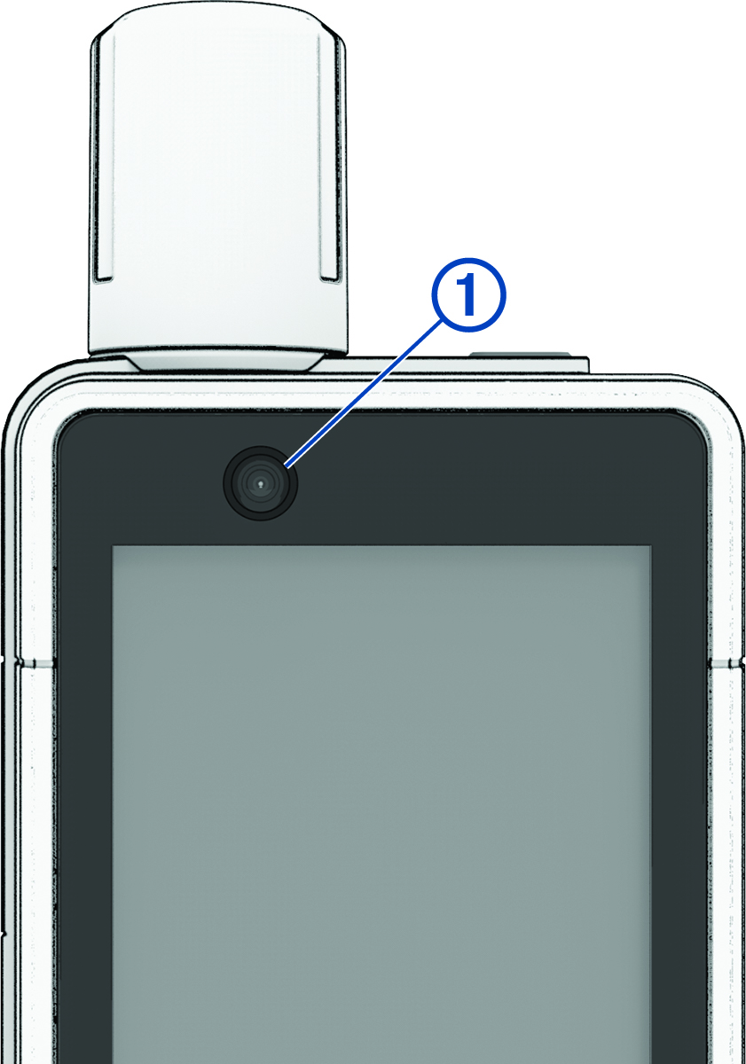

Status LED
The status LED 1 indicates the device status.
Close-up view of the LED with a callout
LED Activity
Status
Double flashing green
You have an unread inReach® message on your GPSMAP® H1i Plus satellite communicator.
Flashing green
The device is in expedition mode.
The screen is turned off to maximize battery life.
Flashing red
An inReach message failed to send from your GPSMAP H1i Plus satellite communicator.
The device is below 10-percent battery power.
Alternating red and green flashes
The GPSMAP H1i Plus satellite communicator is in SOS mode.
