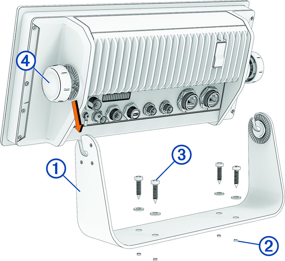

You can use a bail mount bracket (sold separately) to bail mount the device on a flat surface.
  1. Using the bail-mount bracket Callout number 1 as a template, mark the pilot holes.
    Device bail-mount installation with callouts
  2. Drill the pilot holes Callout number 2.
  3. Use either the mounting screws included with the bracket Callout number 3 or your own mounting hardware to secure the bail-mount bracket to the mounting surface.
  4. Install the bail-mount knobs Callout number 4 on the sides of the device.
  5. Place the device in the bail-mount bracket and tighten the bail-mount knobs.
