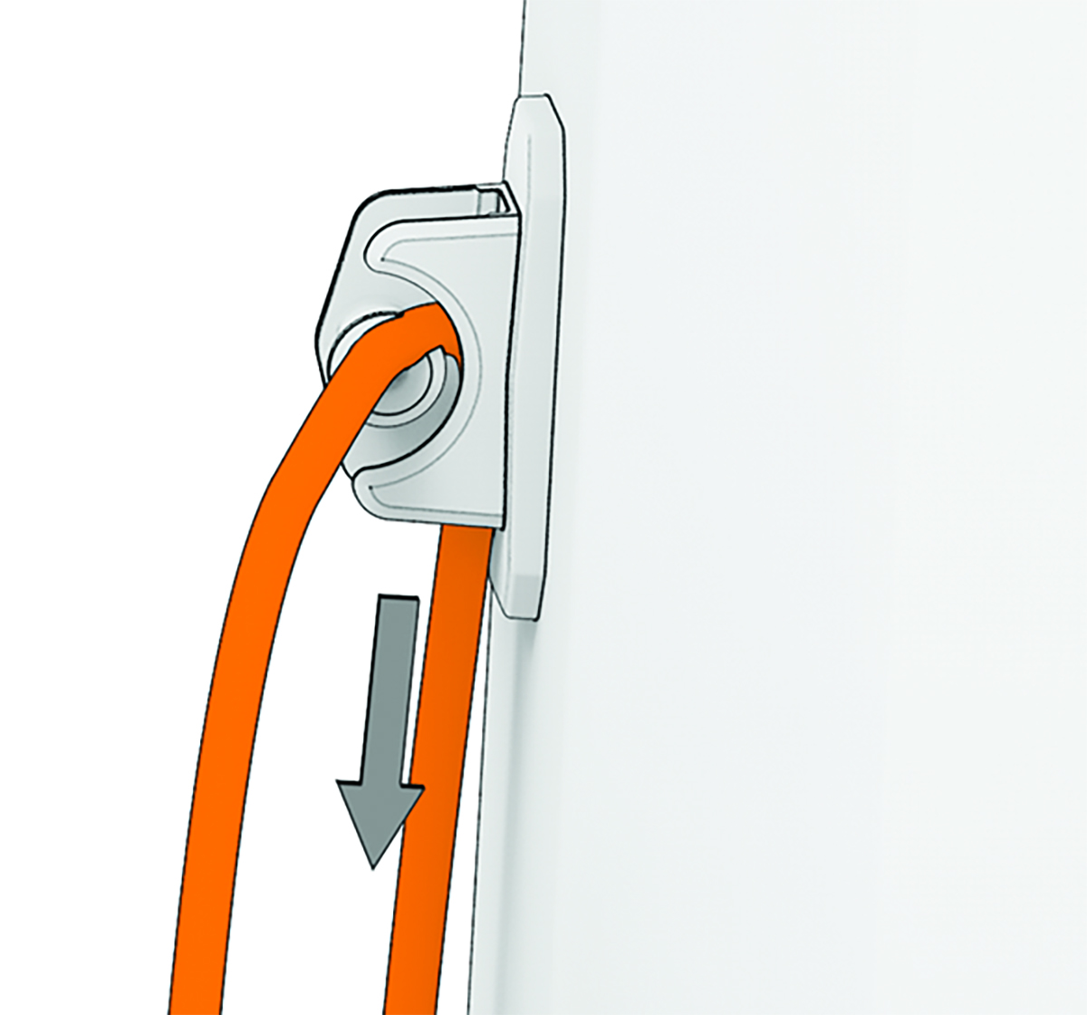

  1. Pull the top of the rope partly out of the open side of the eyelet on the front of the motor steering system, and pull the lower part of the rope down until it slips out of the eyelet.
    Removing the rope from the eyelet

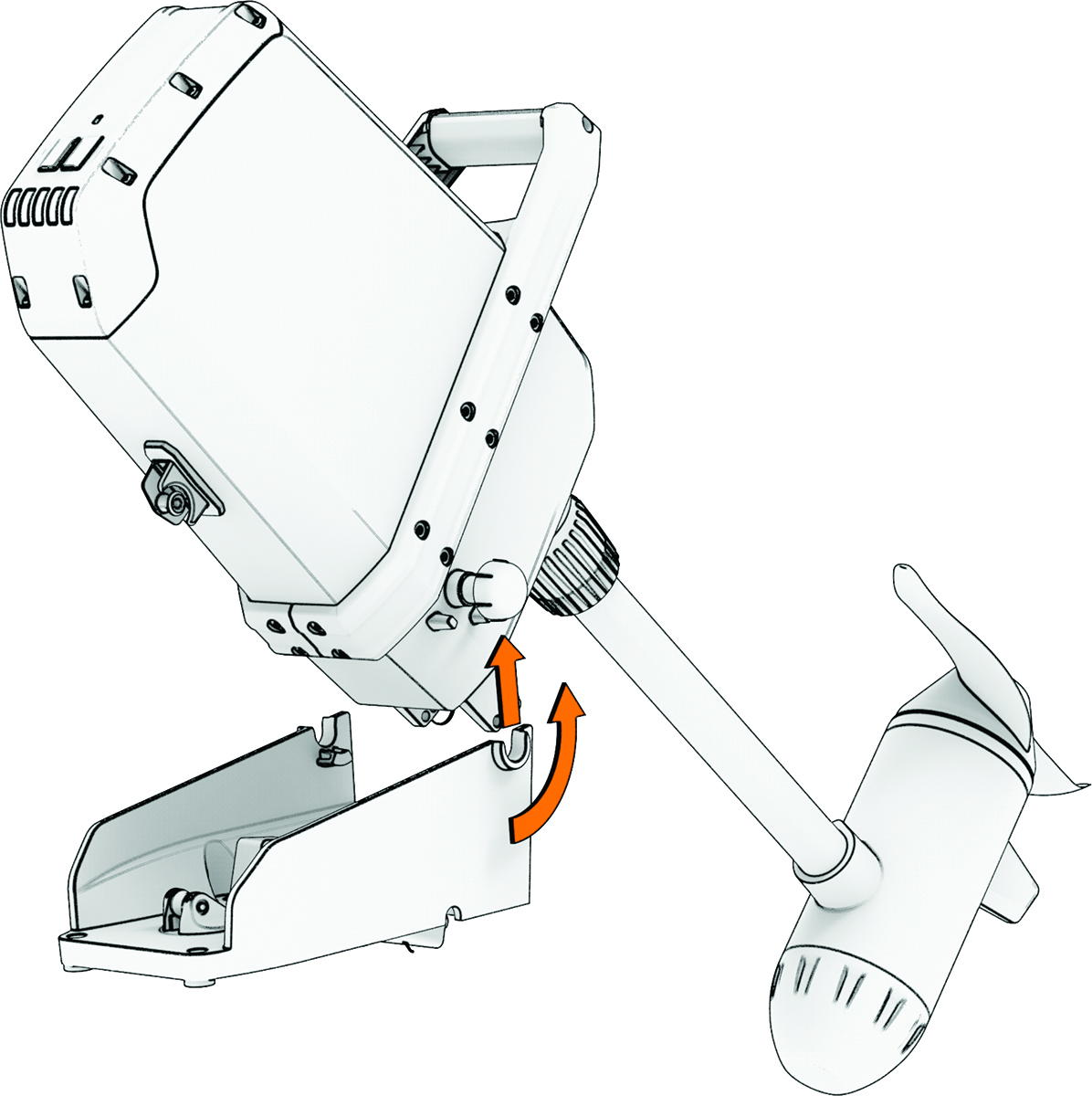

  2. Unscrew the knobs on both sides of the motor until they stop.
  3. Tilt the motor up to an approximately 45-degree angle using the handle on the back of the motor.
    If the motor is in the deployed position, you must pull the rope up to release the mount latch before you can tilt the motor.
    Removing the motor from the mount.
  4. Lift the motor off of the mount using both hands.
