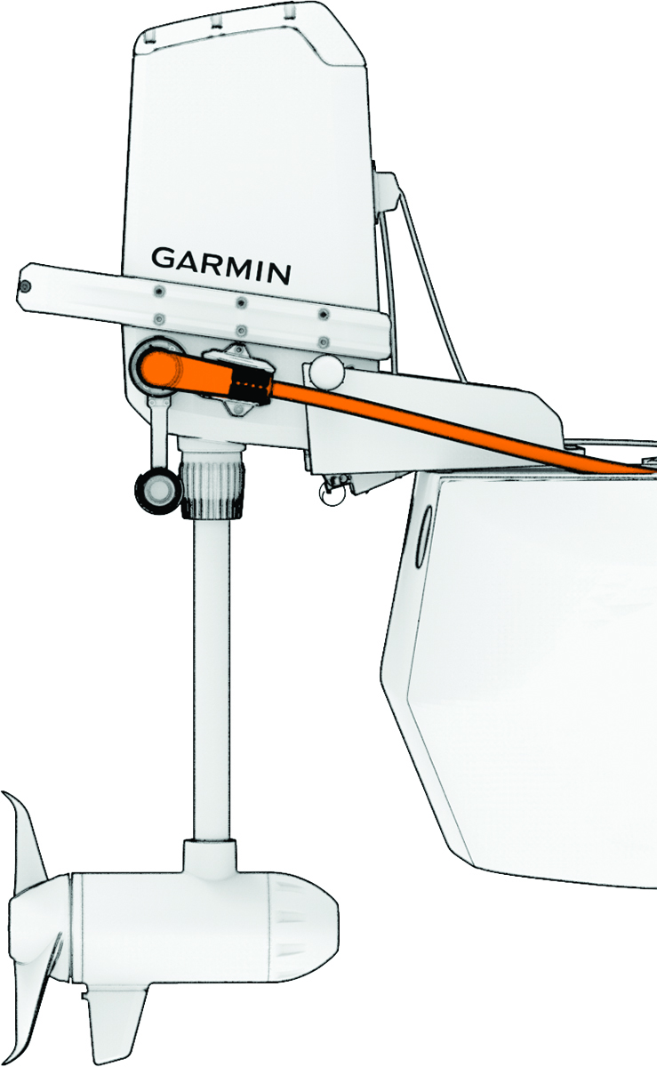

    Motor with power cable connected
    The power cable strain relief rests against the cradle on the motor housing.
