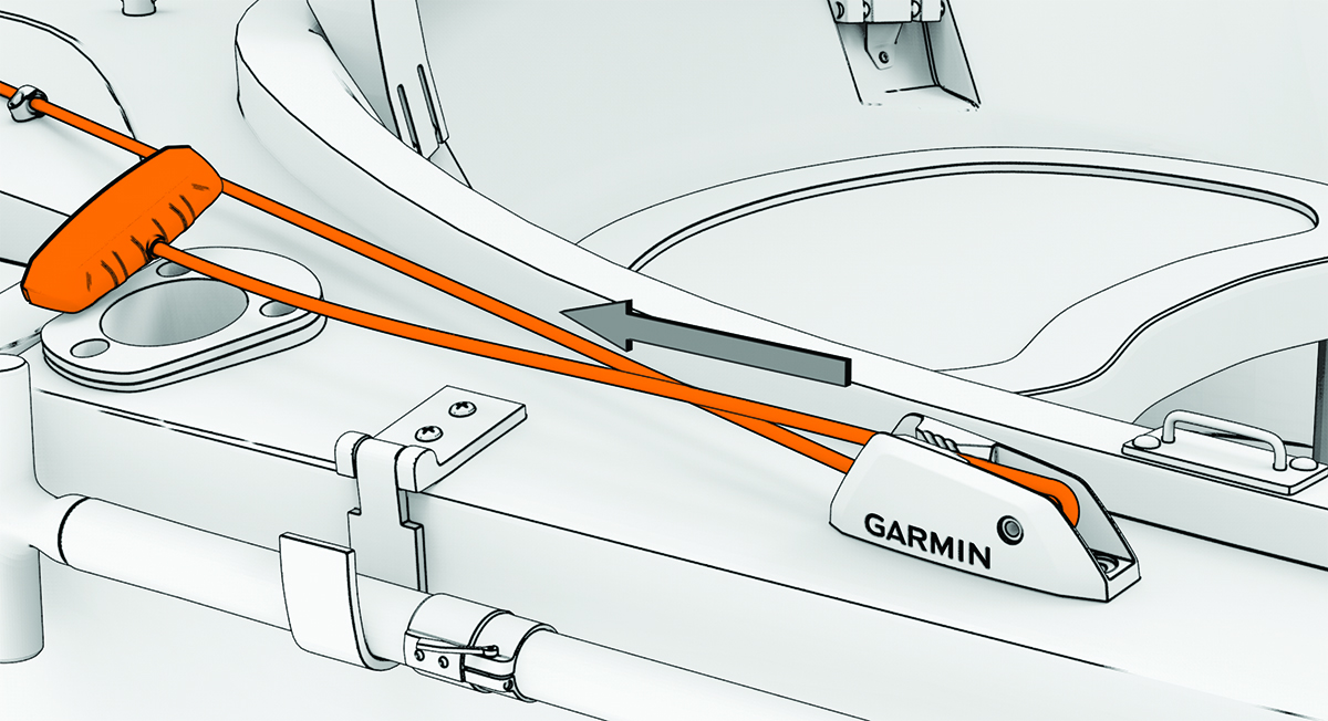

Stowing the Motor
  1. Pull the rope handle toward the motor, lifting the propeller drive motor out of the water.
  2. Lower the rope so that it catches in the cleat, and gently release the tension.
    Pulling the rope to stow the motor
    The rope is secure under tension in the cleat, holding the motor in the stowed position.
