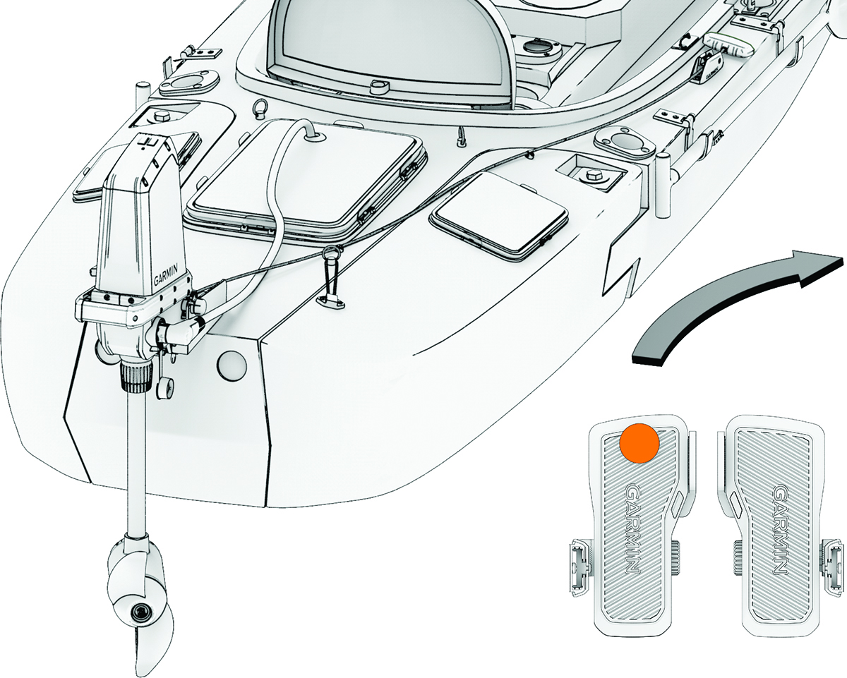

  • To turn left, tilt the right-side pedal forward while keeping the left-side pedal in the neutral position.
    Steering left
    The nose of the propeller drive motor turns to the right, turning the kayak to the left.

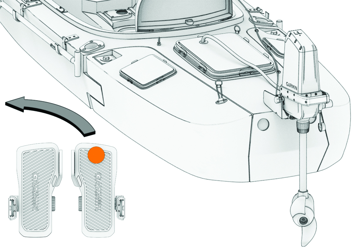

  • To turn right, tilt the left-side pedal forward while keeping the right-side pedal in the neutral position.
    Steering right
    The nose of the propeller drive motor turns to the left, turning the kayak to the right.
