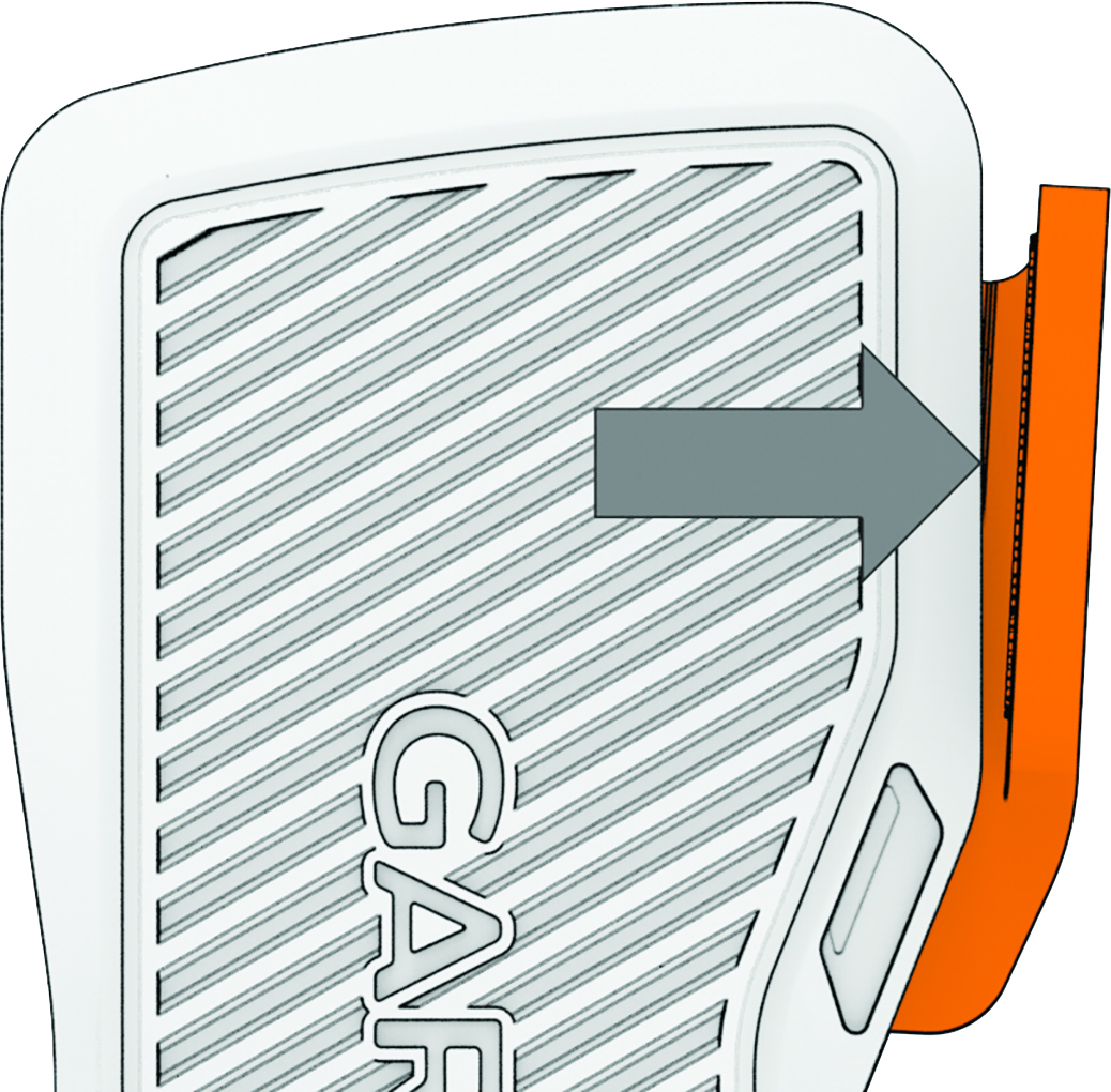

  3. Bring a foot pedal within 1 m (3 ft.) of the trolling motor.
  4. Push the lever on the foot pedal three times.
    Pushing the pedal lever
    The LED indicator light on the foot pedal flashes blue as it searches for a connection, and turns solid green when the connection is successful.
