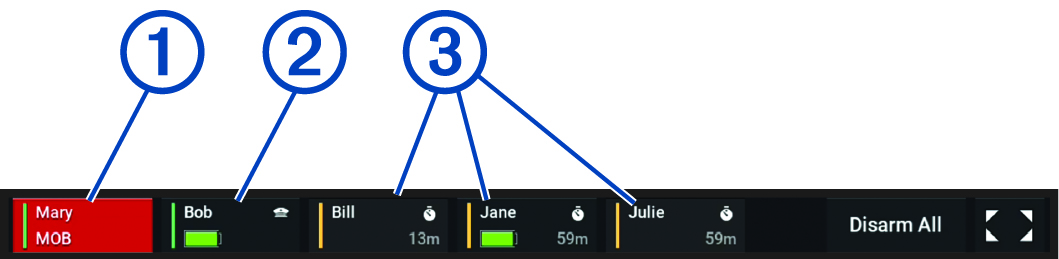

When connected to a GOS™ 10 hub, you can add an overlay on the chartplotter to control MOB tag functions.
MOB tag overlay
1
Protected Passenger tag in Man Overboard (MOB) status:
  • The green line on the left indicates that the tag is protected.
  • The red shading and "MOB" text indicates that the tag has left the range of the hub and is now in an active MOB status (MOB Tag Behavior).
2
Protected Captain tag:
  • Captain tag icon indicates that this is a captain tag.
3
Disarmed Passenger tags:
  • The yellow line on the left indicates that the tag is disarmed.
  • The Disarmed timer icon and time indicate when the system will attempt to protect the tag again automatically.
Disarm All
Sets all connected tags to the Disarmed status.
Full screen symbol
Opens the full-screen MOB tag page.
