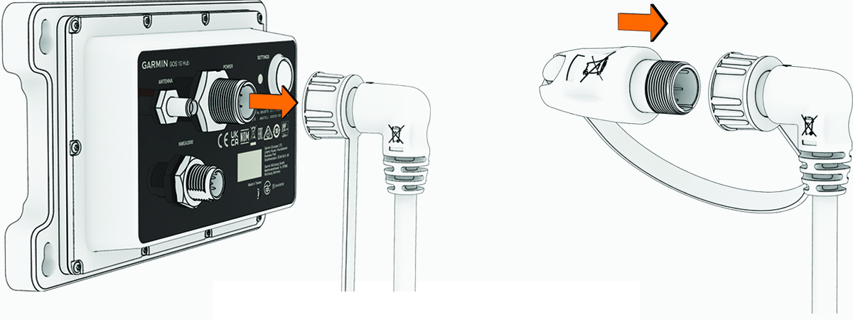

  1. Disconnect the wiring harness from the GOS 10 hub.
    Bypassing the system
  2. Connect the bypass module to the wiring harness connector, and tighten the locking ring.
    The bypass module should be tethered to the connector end of the wiring harness.
    The Garmin OnBoard engine cutoff system is now disabled, and the engines should be restored to previous functionality.
    NOTICE
    The system remains disabled until you enable it again. You must enable the system as soon as possible to be compliant with the AYBC A-33 standard.
To restore the Garmin OnBoard engine cutoff system again, disconnect the bypass module and reconnect the wiring harness to the GOS 10 hub.
