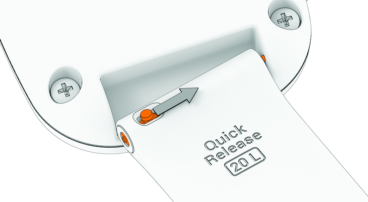

  1. Insert one end of the spring bar on the band or carabiner loop into one of the holes on the MOB tag.
  2. Slide the quick-release pin to retract the other end of the spring pin.
    Installing the wrist band
  3. Align the spring bar with the other hole in the MOB tag, and release the pin.
