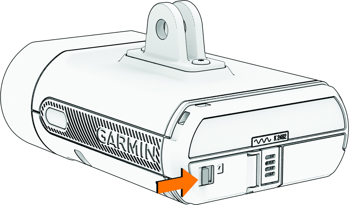

  1. On the back of the device, slide the tab to unlock the memory card cover.
    Memory card installation

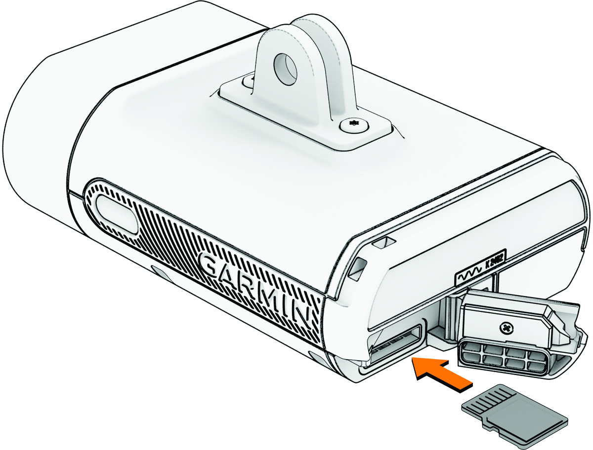

  2. Press the existing memory card in until it clicks, and release the card.
    The existing memory card ejects from the slot.
  3. Remove the existing memory card from the slot.
  4. With the gold contacts facing upward, insert the new memory card into the slot.
  5. Press the memory card in until it clicks.
  6. Close and latch the cover.
  7. Go to the Varia™ app to format the memory card (Formatting Your Memory Card).
