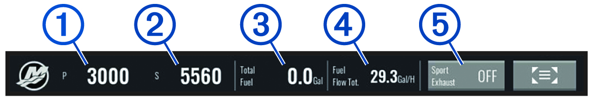

Mercury engine bar with callouts
1
Port engine RPM
2
Starboard engine RPM
3
Total available fuel
4
Fuel usage
5
Sport Exhaust control (if supported) (Enabling the Mercury Engine Sport Exhaust Setting)

When your chartplotter is connected to a compatible Mercury engine, you can use the Mercury Engine overlay on the chartplotter to enable the Sport Exhaust setting. The Sport Exhaust setting alters the engine sound.
On the Mercury Engine overlay, select Sport Exhaust > On.
