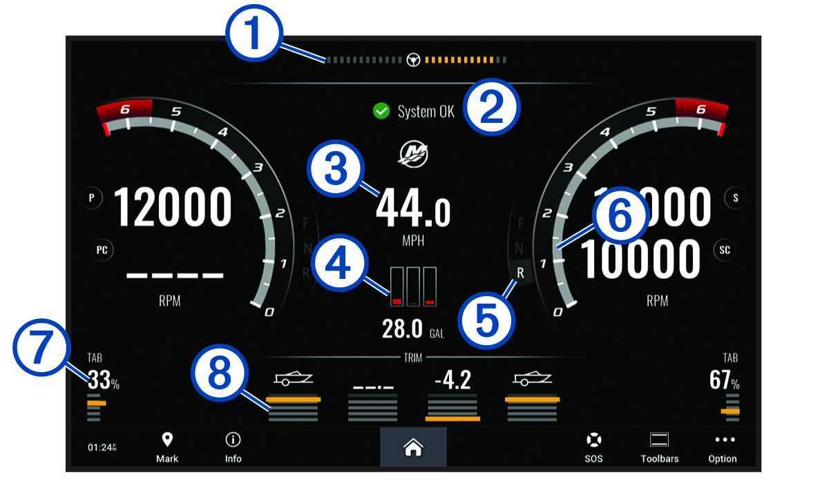

Select Gauges > Mercury to view the Mercury engine gauges.
Mercury gauges screen with callouts
1
Engine voltage or Mercury Steering Angle1
2
Boat status
3
Boat speed
4
Fuel
5
Transmission gear
6
Engine speed
7
Trim tabs
8
Engine trim
TIP: To view additional engine details, select Options > Engine Data.
1 The Mercury Steering Angle may appear on the display, depending on the engine model and configuration, and its location on the display may vary.
