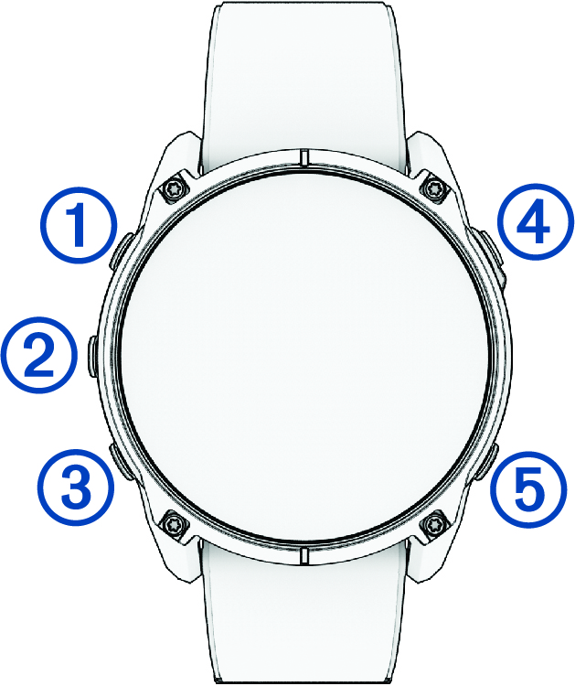

Button Functions
Front view of the watch with callouts
TIP: You can customize some button hold functions and create new button shortcuts (Customizing the Button Shortcuts).
1
Upper-left button
Upper-left button
  • Press to illuminate the screen.
  • Quickly press twice to turn the flashlight on or off (Using the LED Flashlight).
  • Hold for three seconds to turn on the device.
  • Hold for two seconds to view the controls menu (Controls).
  • Hold for five seconds to request assistance (Requesting Assistance).
2
Middle-left button
Middle-left button
  • From the watch face, press to view the notification center (Viewing Notifications).
  • Press to scroll through the menus or data screens.
  • From the watch face, hold to access the main menu.
  • Hold to access a contextual menu, if one is available in that part of the user interface.
3
Lower-left button
Lower-left button
  • From the watch face, press to scroll through the glances list (Viewing Glances).
  • Hold to view the music controls (Listening to Music).
4
Upper-right button
Upper-right button
5
Lower-right button
Lower-right button
  • Press to return to the previous screen.
  • During an activity, press to record a lap, rest, or advance to the next workout step.
  • Hold to view a list of your recently used apps.
