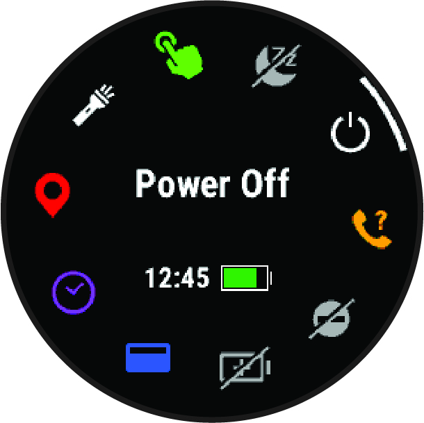

The controls menu lets you quickly access watch features and options. You can add, reorder, and remove the options in the controls menu (Customizing the Controls Menu).
From any screen, hold Upper-left button.
Screenshot of the controls menu
