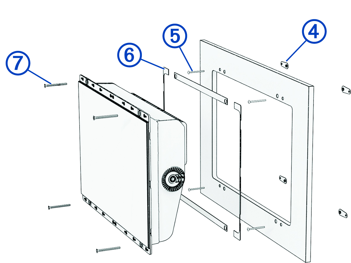

  15. Starting in one corner of the mounting location, place a nut plate 4 on the back of the mounting surface, lining up the large and small holes.
    The raised portion of the nut plate should fit into the larger hole.
    Device flush-mount installation with callouts
  16. Secure the nut plate to the mounting surface by fastening an included M3 screw 5 through the smaller 3.6 mm (9/64 in.) hole.
  17. Repeat steps 15 and 16 for each of the nut plates along the top and bottom of the device.
  18. Install the foam gasket 6 on the back of the device.

  22. Place the device into the cutout.
  23. Secure the device to the mounting surface using the included M4 screws 7 or wood screws, depending on the mounting method.
