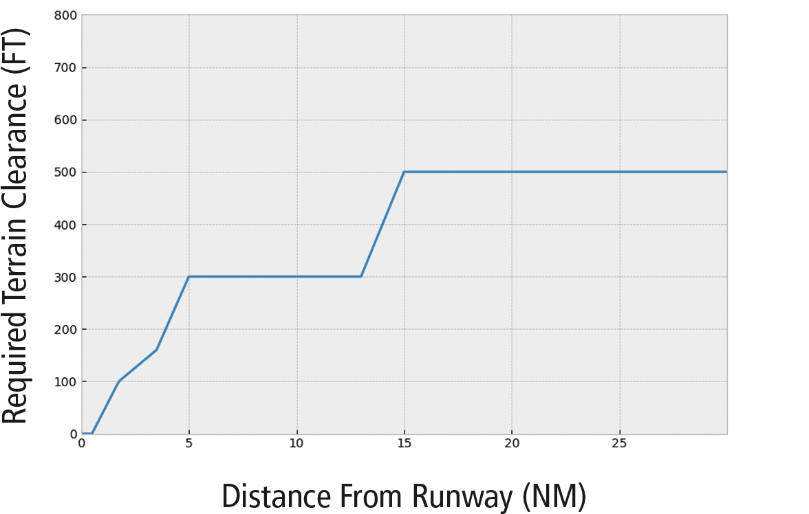

The system issues Reduced Required Terrain Clearance (RTC) and Reduced Required Obstacle Clearance (ROC) alerts when the aircraft flight path is above terrain, yet is projected to come within the minimum clearance values in the following figure. When an RTC alert is issued, the system displays a potential impact area on the ‘Map’ and the PFD.
Imminent Terrain Impact (ITI) and Imminent Obstacle Impact (IOI) alerts occur when the aircraft is below the elevation of a terrain or obstacle in the aircraft’s projected path. ITI and IOI alerts are accompanied by a potential impact area on the ‘Map’ and the PFD. The alert occurs when the projected vertical flight path is calculated to come within minimum clearance altitudes in the following figure.
