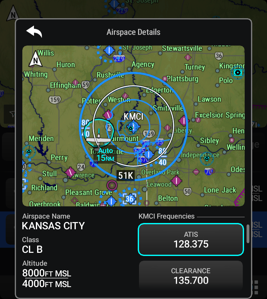

154: 'Airspace Details' Window
A spatial depiction of aircraft proximity to the selected airspace and surrounding airspaces is shown above the list of nearest airspaces. This window also contains information displaying the airspace name, class, and altitude range for the Selected Airspace.
