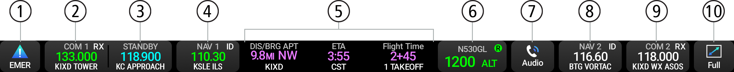

107: CNS Data Bar
1
EMER Button
Opens the Emergency Application to reduce pilot workload in the event of an emergency.
2
COM1 Button
Transfers the standby and active frequencies for the number one radio.
3
Standby Button
Displays a number pad for the corresponding NAV or COM radio to change the standby frequency.
4
NAV1 Button
If no standby button is present, the NAV button will open the NAV 'Standby' window to change and transfer frequencies.
5
(Configurable) Data Bar
See the Data Bar section in System Overview for more information.
6
Transponder
Displays aircraft ID, transponder code and mode, and whether receiving or transmitting. If touched it will open the 'Transponder Control' window.
7
Audio Button
If an internal audio panel is configured, this button will open the 'Audio' window.
8
NAV2 Button
9
COM2 Button
If no standby button is present, the COM button will open the COM 'Standby' window to change and transfer frequencies.
10
Split or Full Button
Toggles the display between full and split screen.
