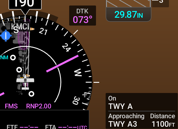

  • Provides information on the Primary Flight Window (PFW) that contains runway and taxiway information that changes as the aircraft moves through the airport environment.
295: SurfaceWatch Information on PFW
