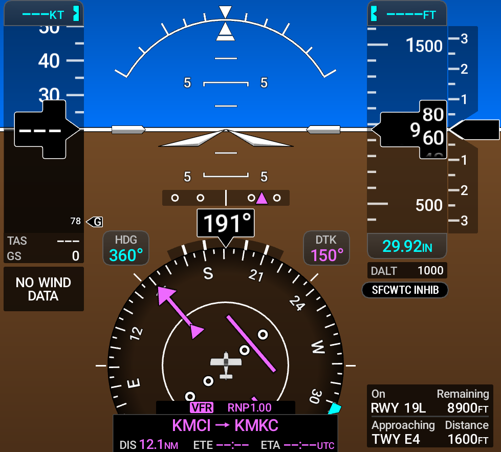

The following image displays the ‘Messages’ Window. The previously discussed annunciations will populate the ‘Messages’ Window as applicable. In the below image, 'SFCWTC INHIB' is annunciated.
300: SurfaceWatch Inhibit Annunciation
