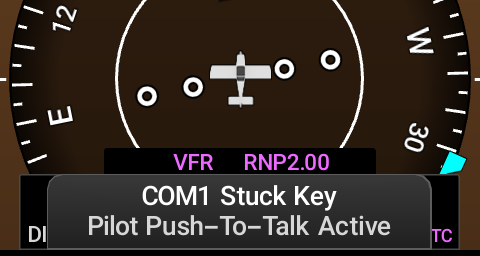

PILOT PTT STUCK
The Pilot Push To Talk key has been in the pressed position for at least 35 seconds. This key will now be ignored.
Verify Push To Talk key is not stuck. Refer to the installation manual for installation wiring tests. Contact Garmin for service if this message persists.
COPILOT PTT STUCK
The Copilot Push To Talk key has been in the pressed position for at least 35 seconds. This key will now be ignored.
BOTH PTT STUCK
Both Push To Talk keys have been in the pressed position for at least 35 seconds. This key will now be ignored.
Verify Push To Talk keys are not stuck. Refer to the installation manual for installation wiring tests. Contact Garmin for service if this message persists.
