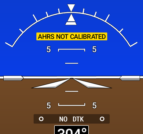

Display system is not receiving attitude information from the ADAHRS.
ADAHRS calibration incomplete or configuration module failure. ADAHRS calibration incomplete or configuration module failure.

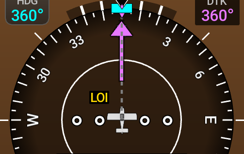

GPS information is either not present or is degraded such that it is invalid for navigation use. Note that ADAHRS utilizes GPS inputs during normal operation may be degraded if GPS signals are not present (see current version of aircraft flight manual).
