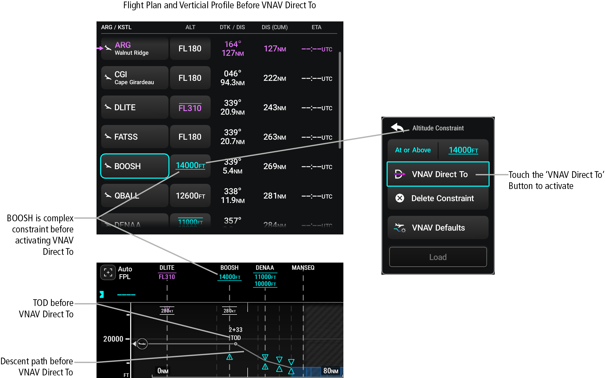

200: VNAV to an Altitude Constraint at a Waypoint Before Activation

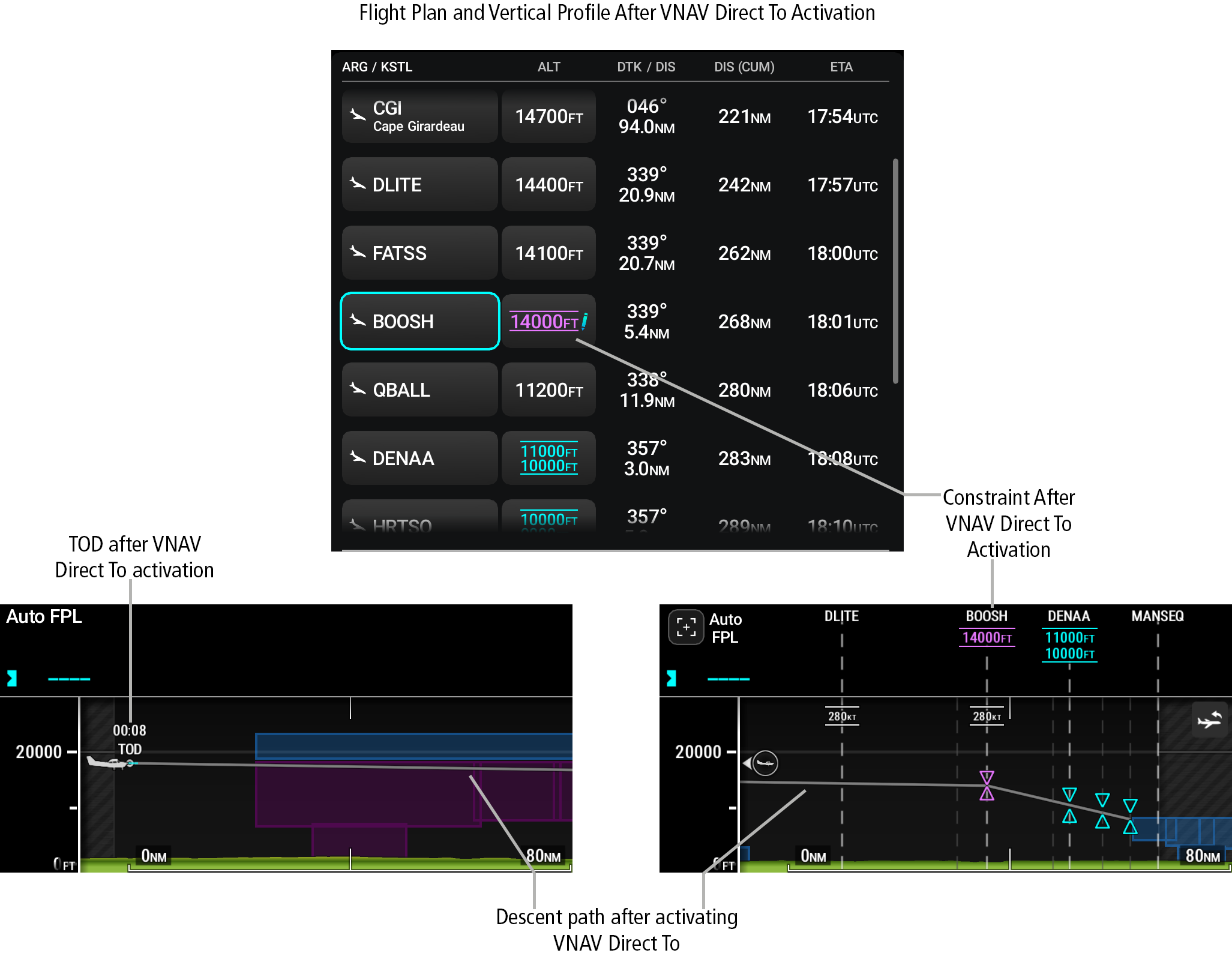

201: VNAV to an Altitude Constraint at a Waypoint After Activation
