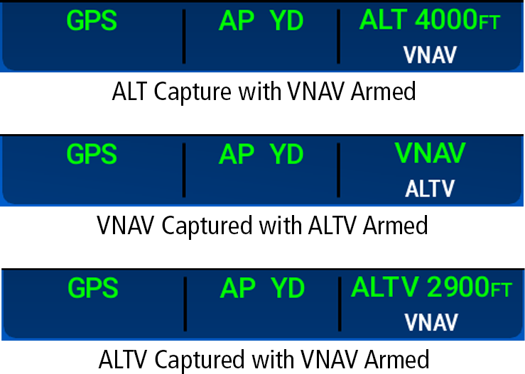

Activating Vertical Navigation Mode:
  • When a flight plan is active, VNAV data is valid, and the VNAV Key is selected on the GMC 507 or VNAV Button on the AFCS Control Window, VNAV mode is armed in preparation for descent path capture. ‘VNAV’ is annunciated in white in the AFCS Status Box. If applicable, the appropriate altitude capture mode is armed for capture of the VNAV Target Altitude (ALTV) or the Selected Altitude (ALTS), whichever is greater.
  • When a descent leg is captured (i.e., vertical deviation becomes valid), VNAV Mode is activated and tracks the descent profile. An altitude capture mode (ALTS or ALTV) is armed as appropriate.
  • When approaching the VNAV Target Altitude (or Selected Altitude) the system automatically transitions to ALTS or ALTV Mode with ALT Mode armed.
286: Vertical Navigation Modes in the AFCS Status Box
