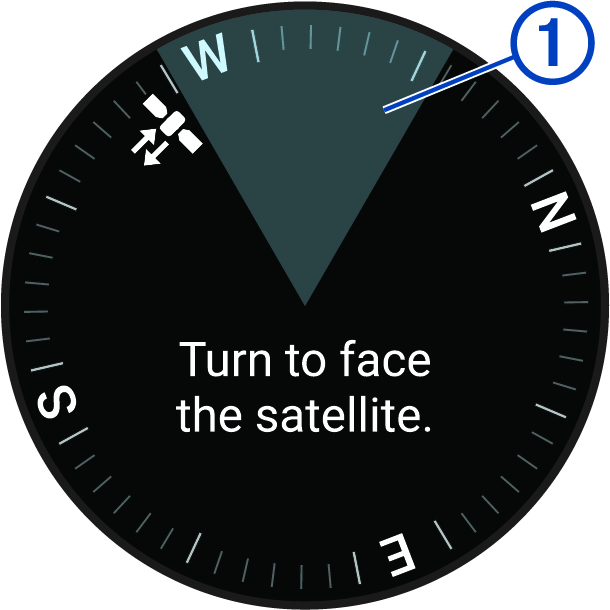

  2. Hold the watch up, and turn until you are facing the satellite with the highlighted region on the compass 1 covering the Satellite icon.
    Screenshot of the satellite pointer with callout
