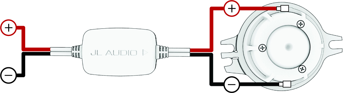

Wiring the CF-275smt
NOTICE
You must use the supplied high-pass crossover or an active filter set to high-pass at 550 Hz, at a rate of 12 dB/octave. Failure to use an appropriate filter will result in damage or failure of the product and will not be covered under warranty.
Use the supplied high-pass crossover to filter the speaker at 550 Hz, at a rate of 12 dB/octave.
Top view of the CF-275smt device wiring
