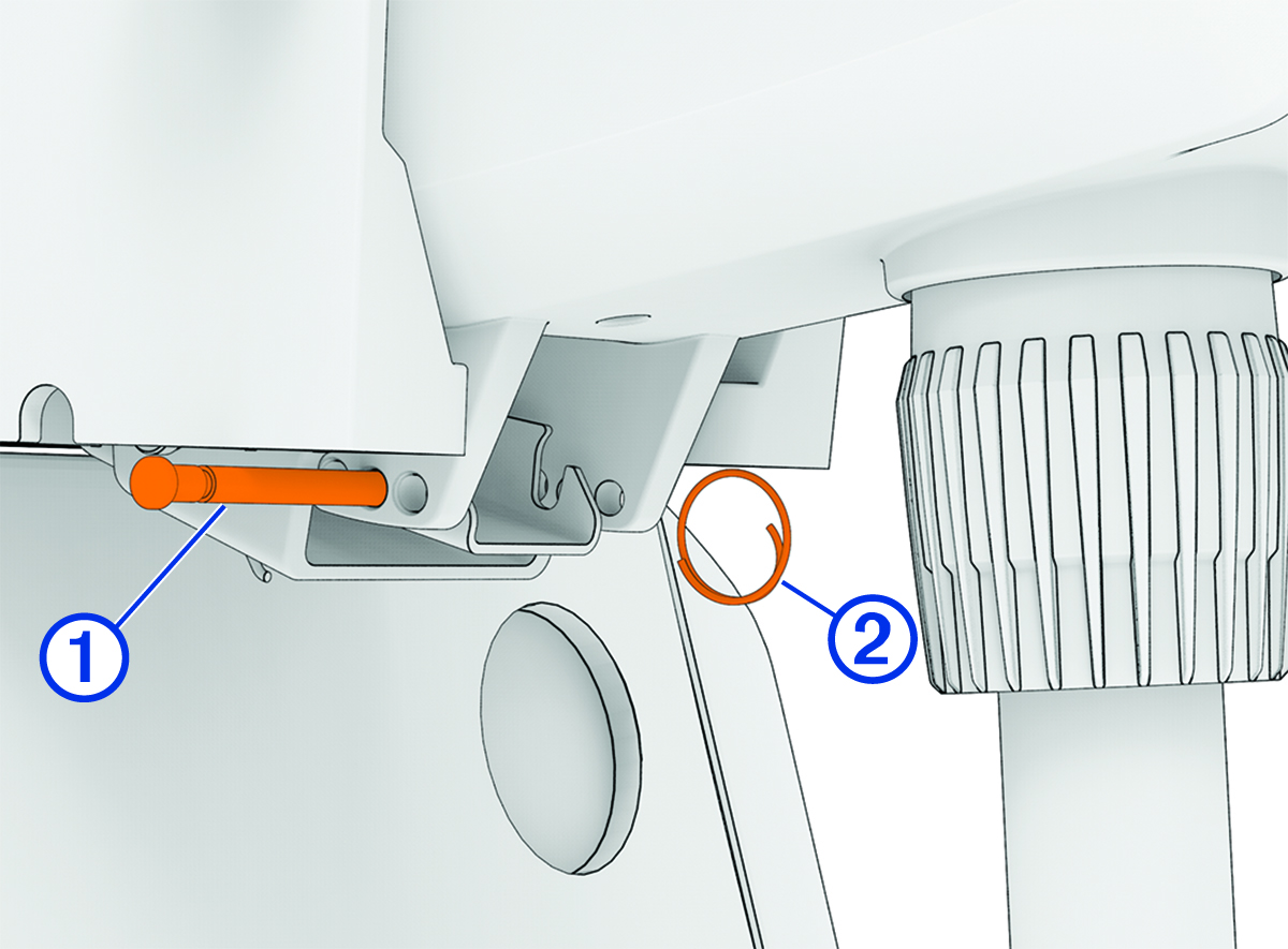

  1. Insert the locking pin 1 through the clevis on both sides of the motor.
    Installing the locking pin with callouts
  2. Install the cotter ring 2 on the end of the locking pin to secure it in place.
When you deploy the motor, the mount latch catches the locking pin, securing the motor in the deployed position.
You should examine the angle of the shaft relative to the kayak, and move the locking pin to one of the other two positions, if necessary, to set the motor shaft at a perpendicular angle to the water surface.
