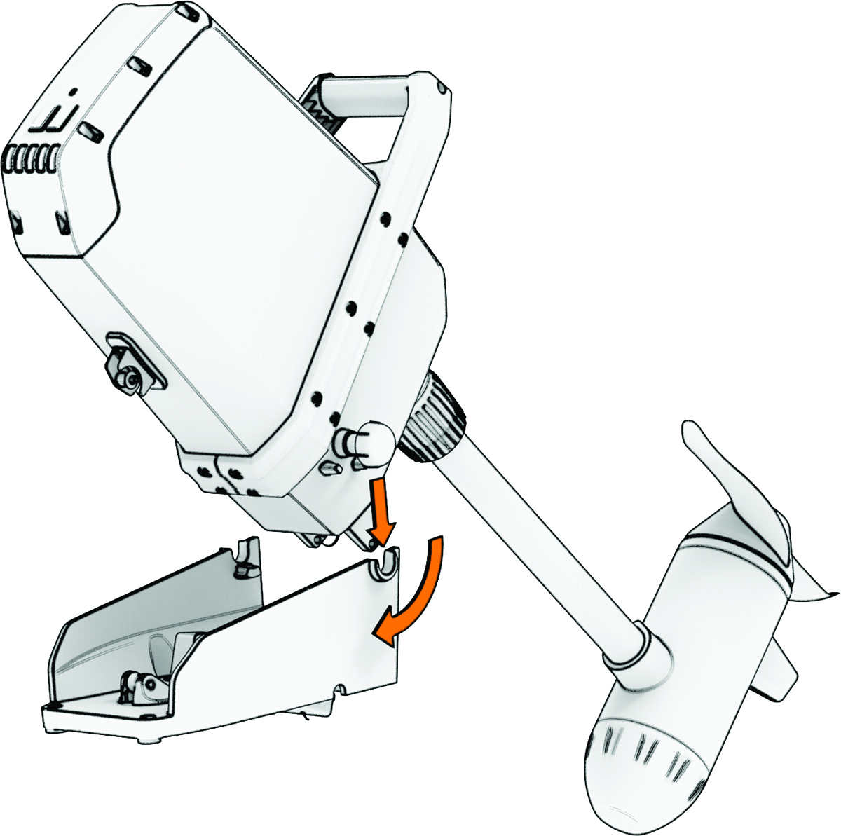

  1. If necessary, loosen the pivot knobs on both sides of the trolling motor.
  2. Lower the motor onto the mount at an approximately 45-degree angle, matching the pivot knobs on the motor with the pivot brackets on the mount.
    Installing the motor
  3. Allow the motor to pivot down to a vertical position.
  4. Tighten the knobs on either side of the motor until they stop.
