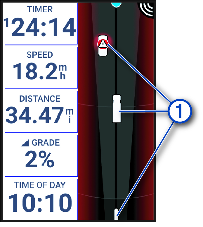

You can add a radar data screen to remotely control your connected Varia RearVue radar device and view radar data. The radar data screen shows a graphical representation of the road behind you, as you are riding. Each icon 1 represents an approaching vehicle. For more information, see the manual for your radar accessory.
Radar screen timer with data and a callout
The vehicle icon moves up and across the screen as the vehicle approaches you, representing the vehicle's position relative to you. The radar calculates a threat level based on vehicle size, speed, and other factors (Enabling the Green Threat Level Tone).
Icon Threat Level
Yellow warning symbol Mid level
Red warning symbol High level
TIP: You can add five data fields to this screen (Editing a Data Screen).
