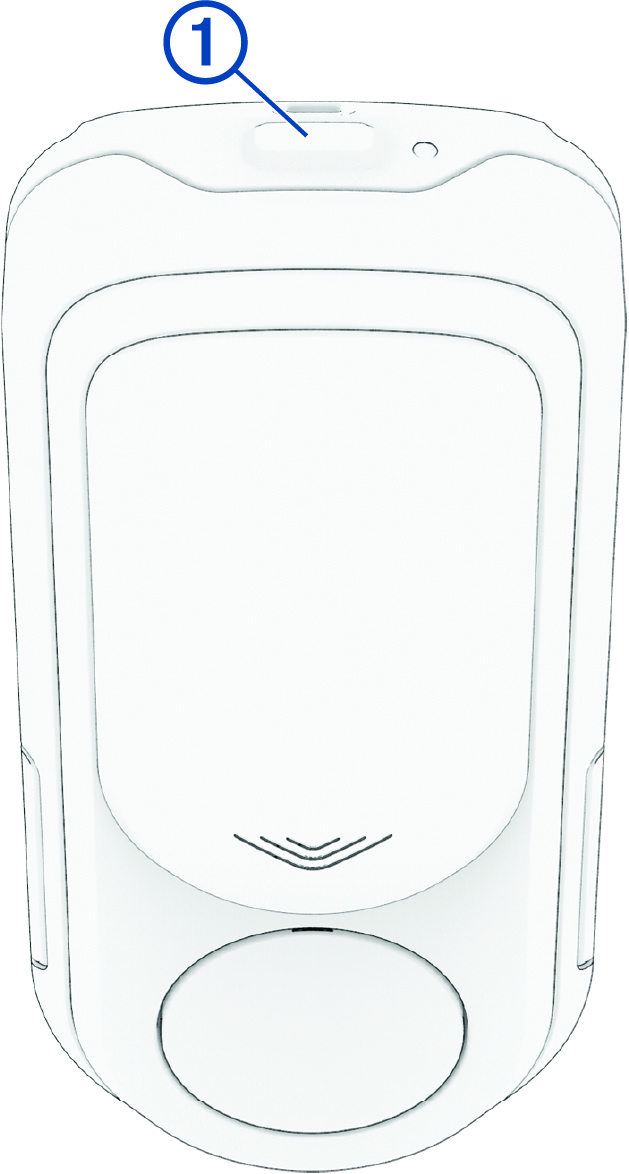

You can change the current light mode by pressing the device button 1.
Device button with callout
