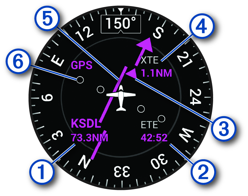

Horizontal situation indicator data with callouts
1
Destination airport identifier and distance.
2
Estimated time en route (ETE).
3
To-and-from indicator. Indicates whether you are headed toward or away from the waypoint.
4
Cross-track distance.
5
Course deviation indicator (CDI). Indicates the location of the desired course line in relation to your location.
6
Course deviation distance. The dots indicate your distance off course. The maximum of two dots equals 2.5 nautical miles.
