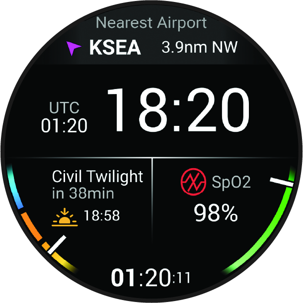

  6. Press Line drawing of the watch with a top button callout to start the activity timer.
    Flying activity with data
