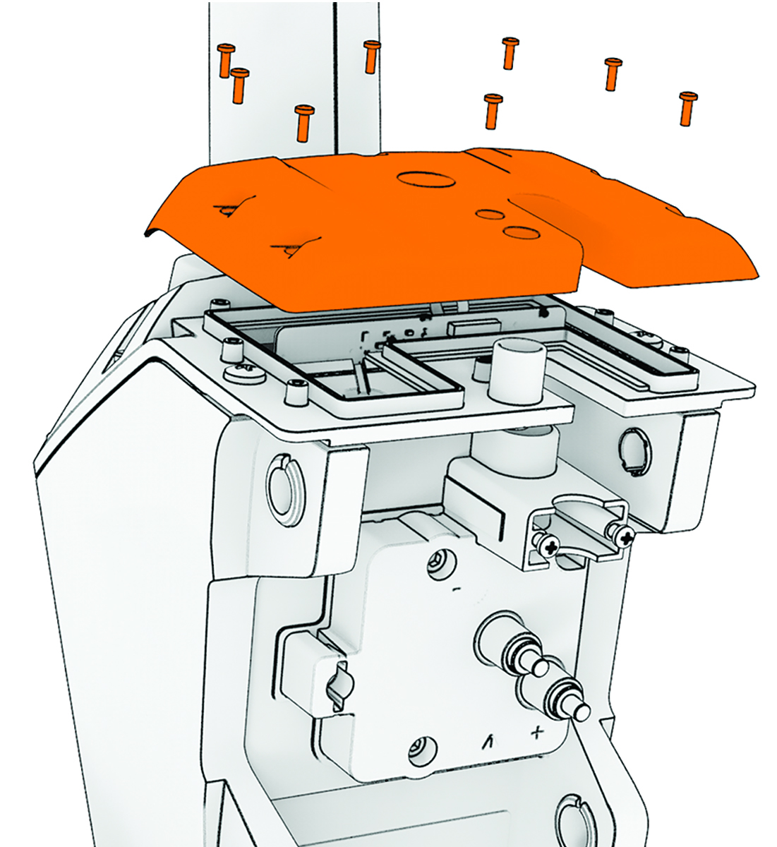

Removing the Electronics Cover Using a T-10 TORX® screwdriver, remove the eight screws that secure the electronics cover to the steering system housing. Lift up and remove the electronics cover. Child Topics:Reinstalling the Electronics CoverParent Topic: Service ProceduresHomeService ProceduresRemoving the Electronics Cover
