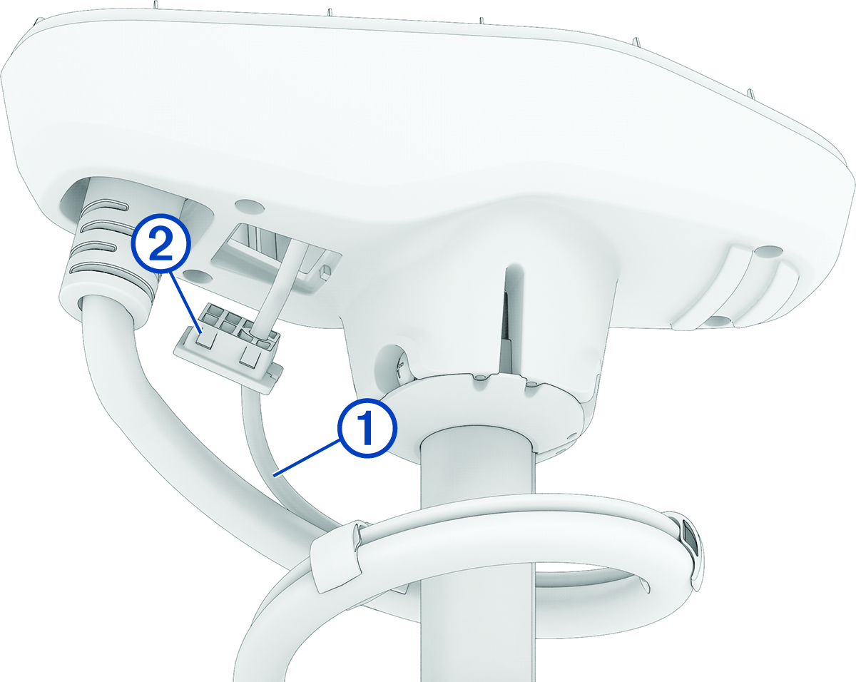

Reinstalling the Transducer Cable
  1. Feed the transducer cable 1 completely through the square hole in the shaft cap.
    Outer shaft cap cables with callouts
  2. Install the grommet 2 on the transducer cable.
    The grommet is split on one side to make it easy to install on the cable.
  3. Push from the outside to secure the square grommet in the shaft cap.
  4. Route the transducer cable alongside the coil cable, using the cable clamps to hold the cables together.
  5. Route the transducer cable through the mount base alongside the coil cable, using the cable clamps to secure the cables to the base.
  6. Route the transducer cable to the chartplotter and connect it.
