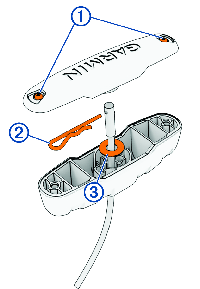

  2. Using a #1 Phillips screwdriver, loosen the two screws 1 that secure the top of the handle.
    Pull-cable handle disassembly with callouts
  3. Push the pull cable up from the bottom of the handle, and remove the R-pin 2.
  4. Pull the cable out through the washer 3 and the bottom of the handle.
