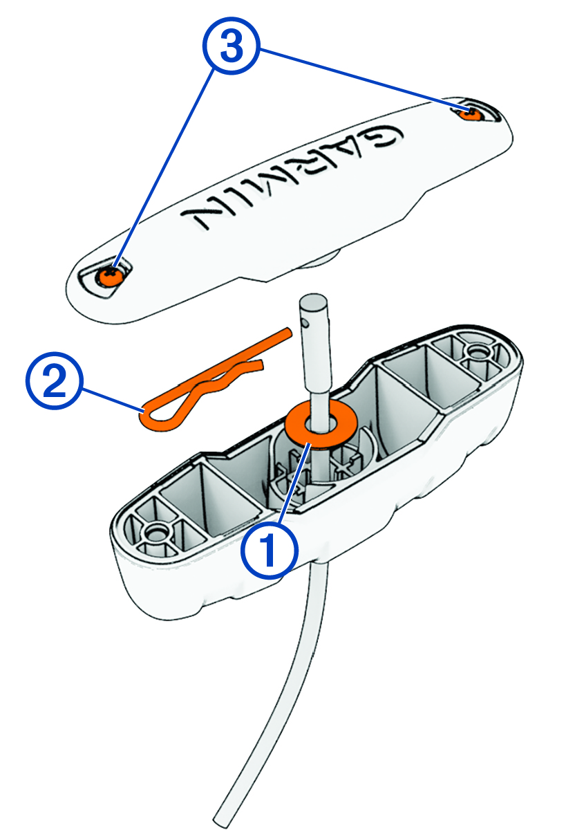

  1. Insert the pull cable through the handle.
    Exploded view of handle with callouts
  2. Insert the pull cable through the washer Callout number 1.
  3. Push the R-pin Callout number 2 through the hole on the end of the pull cable.
  4. Pull the cable down so that the washer and R-pin rest fully in the handle.
    NOTE: If the washer and the R-pin are not fully seated in the handle, you will not be able to install the handle cover.
  5. Place the handle cover on the handle and, using a #1 Phillips screwdriver, tighten the screws Callout number 3.
