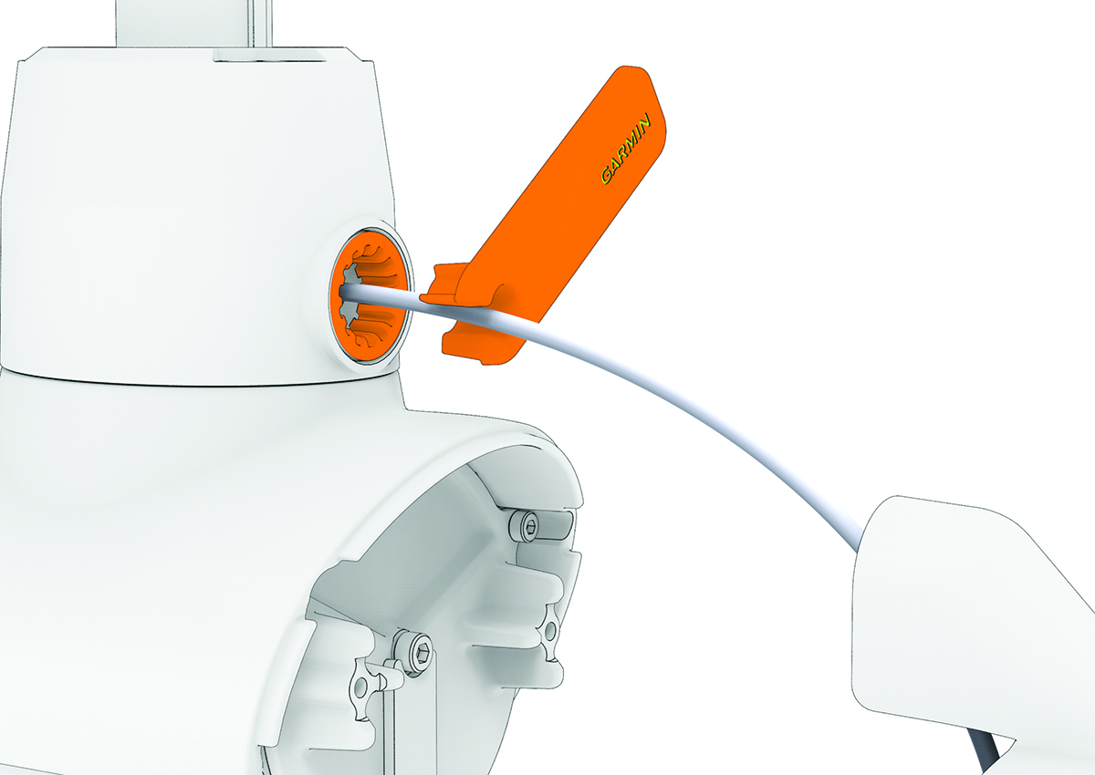

Removing the recessed nut to release the transducer cable requires a custom spanner wrench. The spanner wrench is included in the transducer replacement kit and in the shaft hardware service kit.
  1. Using the custom spanner wrench, remove the recessed nut that secures the transducer cable to the shaft.
    View of the nut-removal tool with callouts

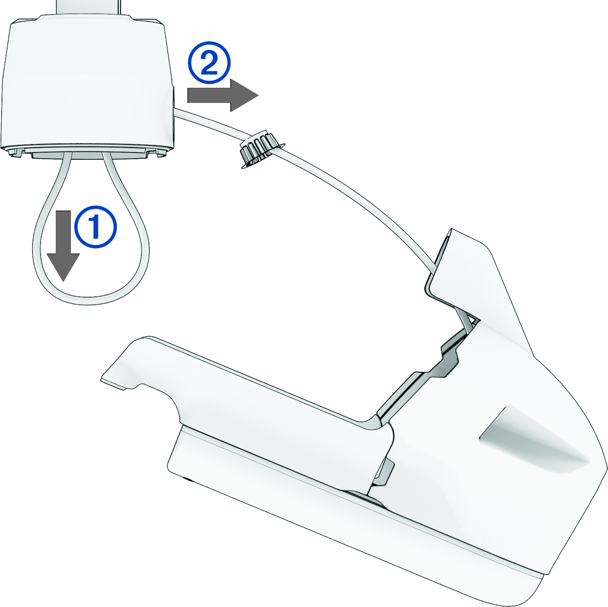

  2. Carefully pull the transducer cable straight down 1 through the bottom of the shaft until it is completely removed from the shaft.
    View of transducer wire removal with callout
  3. After you pull the transducer cable through the shaft completely, pull it through the hole in the front of the shaft base 2, along with the cable gland.
