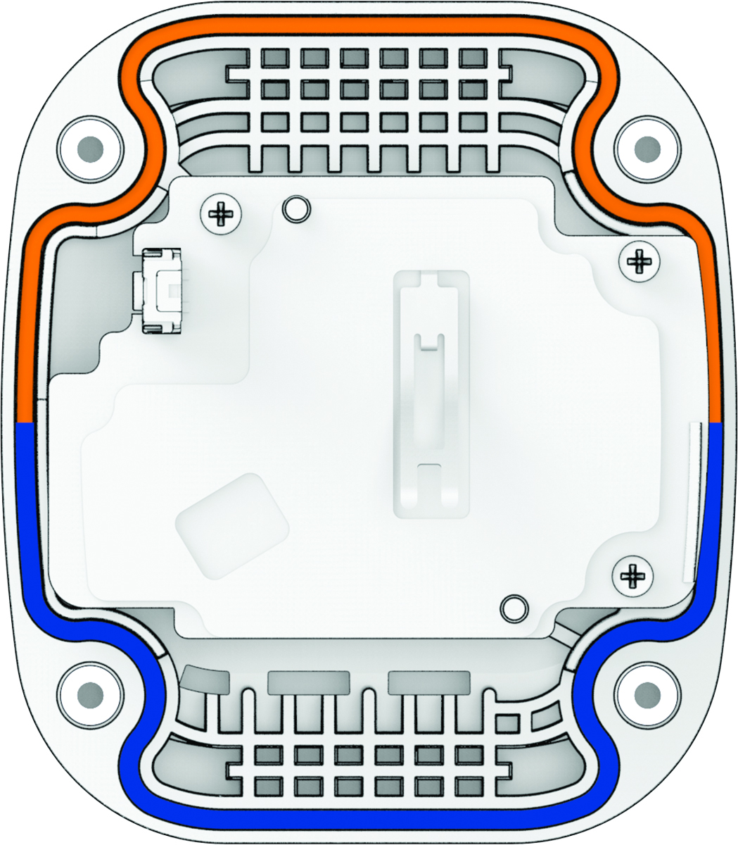

  4. Make sure the rubber gasket in the front cover of the MOB tag is not broken and is fully seated in its groove.
    The gasket fits in the groove in a specific orientation.
    NOTICE
    If the gasket is not properly and fully seated in the groove, it does not create a seal, which leads to the failure of the MOB tag when it is exposed to water. Contact Garmin® product support for information on purchasing a replacement gasket.
